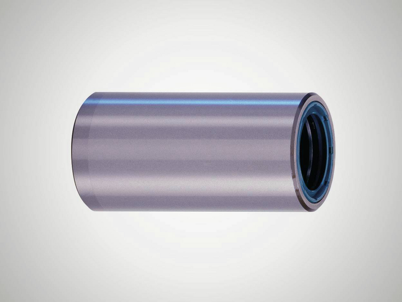

Guide Bush N553
Art. no. 5009047
- Sealing and stop rings fixed on both sides.
- The closed guide bush and integrated ball cage form a separate component. Guide bore diameter d1 is finely honed to ISO tolerance IT 3, Rz 0.5 – 1.5 μm depending on diameter.
- Roundness within 1/3 ISO-IT 3.
- Cylindricity within IT 1.
- Radial run-out of a shaft inserted under preloading is within 0.0005 mm.
- Outside diameter dB n4 with radial run-out error within IT 4, ground to guide bore diameter d1, lead-in taper on one side.
- The maximum stroke path Hmax of the rotary stroke bearing is determined from the length of guide bush l3 and the length of the ball cage l2: Hmax = 2 (l3-l2).
- See catalog page 37-41 for instructions on installation and servicing.

| MarMotion N553 | Item no.: 5009047 | |
| material | Steel |
| material number | 1.3505 (AISI E52 100) |
| heat treatment | through-hardened |
| constant working temperature | 100 °C |
| shaft diameter (dw) | 6 mm |
| Inner diameter of guide bush (d1) | 10 mm |
| Length of guide bush with sealing (L) | 31 mm |
| Length of guide bush (l1/L) | 31 mm |
| Inner dimension of guide bush (l3) | 23 mm |
| Outer diameter of guide bush (dB) | 14 mm |
| outer diameter tolerance | n4 |
| Dimensions | dw 6 | dB 14 | L 31 | l1/L 31 | d1 10 | l3 23 |
