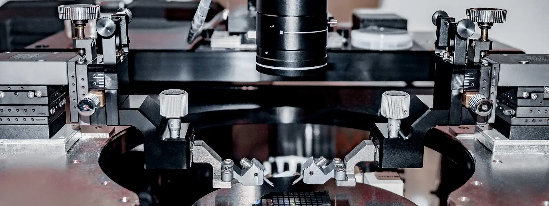

More than in any other industry sector, technical progress in semiconductor production is advancing rapidly to produce increasingly finer structures in ever shorter time. Growing demands on the quality of workpieces go hand in hand with the requirement for shorter cycle times.
Productivity - steady and reliable
A rotary stroke bearing is the ideal solution for many applications. The rotary stroke bearing combines precision and rigidity in a unique way with compact dimensions. The large number of balls in the ball cage allows high rigidity in all directions. The precisely set preload ensures zero backlash and reliable rigidity, perfect for fast movements in short cycle times.
Minimal friction due to finely machined surfaces, the best materials and carefully hardened steel ensure a long service life, high level of reliability and low maintenance. Downtimes due to maintenance or repair, which are particularly critical in the semiconductor manufacturing sector, can be reduced significantly.
Materials that enable the use in a vacuum or cleanroom are available upon request.
