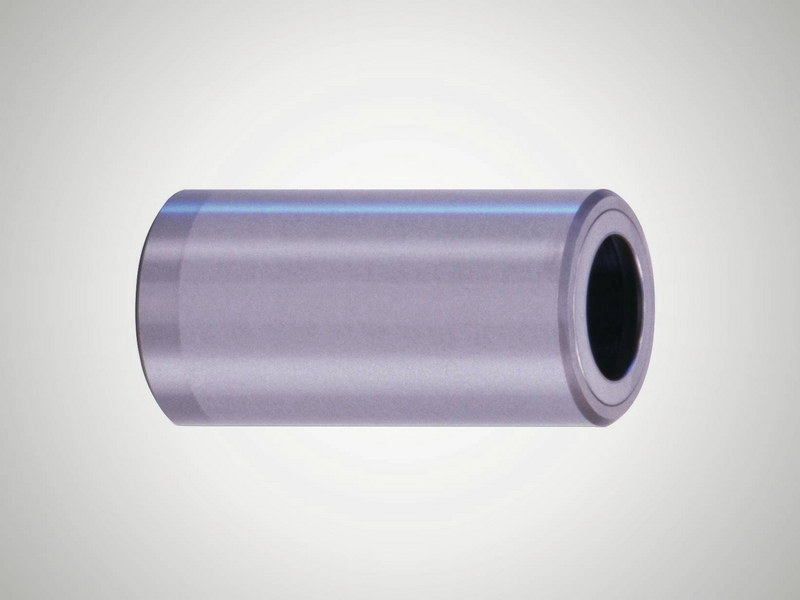

Guide Bush N552
Art. no. 5003048
  • Stop rings fixed on both sides.
  • The closed guide bush and integrated ball cage form a separate component.
  • Guide bore diameter d1 is finely honed to ISO tolerance IT 3, Rz 0.5 – 1.5 μm depending on diameter.
  • Roundness within 1/3 ISO-IT 3.
  • Cylindricity within IT 1.
  • Radial run-out of a shaft inserted under preloading is within 0.0005 mm.
  • Outside diameter dB n4 with radial run-out error within IT 4, ground to guide bore diameter d1, lead-in taper on one side.
  • The maximum stroke path Hmax is determined from the length of guide bush l3 and the length of the ball cage l2: Hmax = 2 (l3-l2).

MarMotion N552 | Item no.: 5003048
material Steel
material number 1.3505 (AISI E52 100)
heat treatment through-hardened
constant working temperature 150 °C
shaft diameter (dw) - Mini 10 mm
Inner diameter of guide bush (d1) 13 mm
Length of guide bush (l1/L) 40 mm
Inner dimension of guide bush (l3) 38 mm
Outer diameter of guide bush (dB) 18 mm
outer diameter tolerance n4
Dimensions dw 10 | dB 18 | l1/L 40 | d1 13 | l3 38
