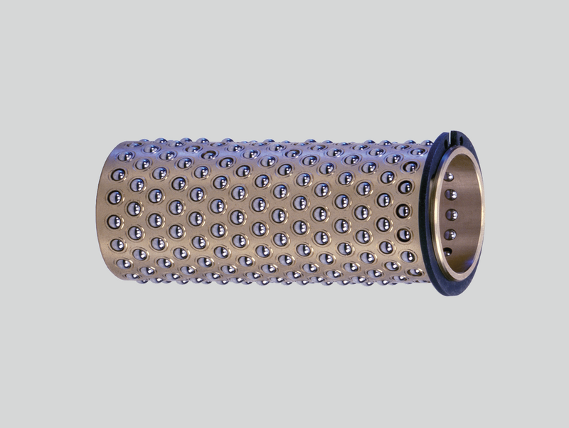

Ball Cage N511
Art. no. 5001129
- The ball chambers are mechanically caulked so that the balls remain captive but still move easily.
- Large number of balls ensures high loading capacity.
- Brass offers high mechanical stability, optimum sliding properties, and high resistance to abrasion and heat.
- See catalog page 37-41 for instructions on installation and servicing.
For detailed information please select an item.
The ball cages can be supplied with stainless steel or ceramic balls. Other dimensions or designs are available on the basis of workpiece drawings and can be produced using different cage materials.
Ball Cage N 511/dw/d1/l2 Order No. 50011 . .

| MarMotion N511 | Item no.: 5001129 | |
| material | Brass |
| material number | 2.0402 (CuZn40Pb2) |
| ball material | roller bearing steel |
| number of balls | 192 |
| C - Load rating (radial) | 2070 N |
| max. torque | 23.93 Nm |
| ball arrangement | arranged in rows |
| constant working temperature | 150 °C |
| shaft diameter (dw) | 18 mm |
| Inner diameter of guide bush (d1) | 24 mm |
| Length of ball cage (l2) | 71 mm |
| distance circlip (f) | 2.8 mm |
| distance 1. ball (l4) | 4.1 mm |
| ball diameter (k) | 3 mm |
| Dimensions | n 71 | dw 18 | d1 24 | l2 71 | l4 4.1 | k 2070 |
