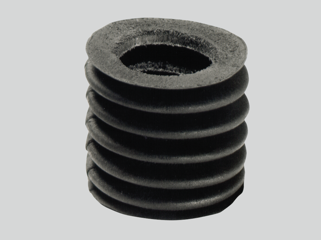

Protect open ball-bearing guides against dirt without compromising smooth movement.
