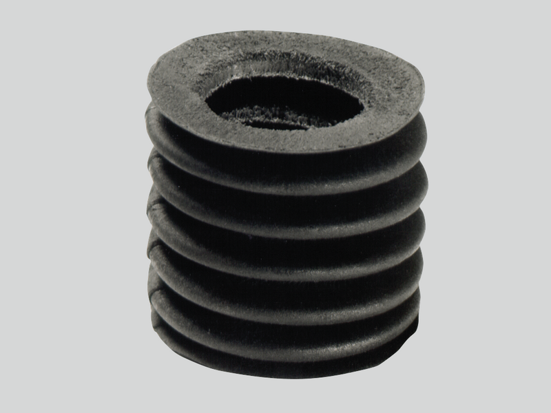

Chrome Leather Bellow
Art. no.
- The relationship between the inside diameter di and the outside diameter da has been selected to give the bellows good stability.
- Optimum contraction ratio (l/le).
- Unlike rubber or plastic bellows, leather bellows do not impair the smooth running of the rotary stroke bearing.
- The natural material is resistant to most environmental influences. (Caution should be exercised when using certain coolants!)
N 820/di/da/l/le
- .../a for axial clamping
- .../r for radial clamping
- .../a, r for axial and radial clamping
