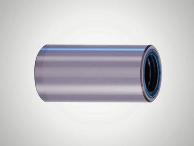

Permanently installed thrust washers on each side and sealing rings prevent impurities from getting into the ball bearing guide.
Extra sturdy model with scrapers on both sides which reliably prevent impurities from getting in, even in very dirty environments.

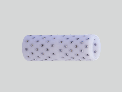

The balls can move easily without getting lost. The balls are arranged in such a way that they run smoothly and ensure a long service life of the ball bearing guide.
Excellent dry run properties and maximum smoothness, even at high accelerations thanks to the lightweight plastic.

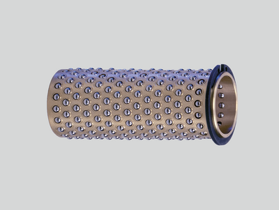

Versatile with balls arranged along a helical line, ideal for linear movements and rotational movements.
Smaller balls used with same shaft diameter compared to type N501. Reduced installation space thanks to guide bushes from the mini series.
High loading capacity thanks to large number of balls, reliable travel limit for the cage thanks to the securing ring.

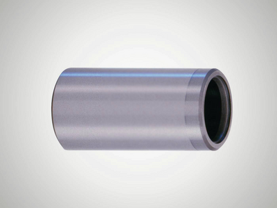

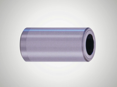

Guide Bush N552
Art. no. 5003060
- Stop rings fixed on both sides.
- The closed guide bush and integrated ball cage form a separate component.
- Guide bore diameter d1 is finely honed to ISO tolerance IT 3, Rz 0.5 – 1.5 μm depending on diameter.
- Roundness within 1/3 ISO-IT 3.
- Cylindricity within IT 1.
- Radial run-out of a shaft inserted under preloading is within 0.0005 mm.
- Outside diameter dB n4 with radial run-out error within IT 4, ground to guide bore diameter d1, lead-in taper on one side.
- The maximum stroke path Hmax is determined from the length of guide bush l3 and the length of the ball cage l2: Hmax = 2 (l3-l2).
- See catalog page 37-41 for instructions on installation and servicing.

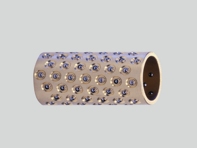

Rotary stroke bearing consisting of:
Guide bush N 552/dw/d1/l1 Order No. 5003 . . .
Ball cage N 501/dw/d1/l2 Order No. 50010 . .
or
Ball cage N 500/dw/d1/l2 Order No. 50000 . .

MarMotion N552 | Item no.: 5003060 | |
material | Steel |
material number | 1.3505 (AISI E52 100) |
heat treatment | through-hardened |
constant working temperature | 150 °C |
shaft diameter (dw) | 12 mm |
Inner diameter of guide bush (d1) | 17 mm |
Length of guide bush (l1/L) | 50 mm |
Inner dimension of guide bush (l3) | 47 mm |
Outer diameter of guide bush (dB) | 22 mm |
outer diameter tolerance | n4 |
Dimensions | dw 12 | l1/L 50 | dB 22 | d1 17 | l3 47 |
