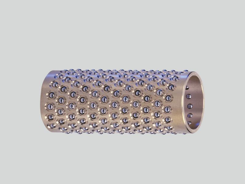

Ball Cage N501
Art. no. 5001090
- The ball chambers are mechanically caulked so that the balls remain captive but still move easily.
- The balls are arranged in an optimum formation so that each ball can run on its own track for both linear and rotary movements.
- The ball formation ensures smooth running and substantially lengthens the service life of the rotary stroke bearing.
- Brass offers high mechanical stability, optimum sliding properties, and high resistance to abrasion and heat.
The ball cages can be supplied with stainless steel or ceramic balls. Other dimensions or designs are available on the basis of workpiece drawings and can be produced using different cage materials.
Ball Cage N 501/dw/d1/l2 Order No. 50010 . .

MarMotion N501 | Item no.: 5001090 | |
material | Brass |
material number | 2.0402 (CuZn40Pb2) |
ball material | roller bearing steel |
number of balls | 662 |
C - Load rating (radial) | 36000 N |
max. torque | 812.7 Nm |
ball arrangement | helical arrangement |
constant working temperature | 150 °C |
max. acceleration, horizontal | 10 m/s2 |
max. acceleration, vertical | 7 m/s2 |
max. rotary speed, rotating shaft | 2150 1/min |
max. rotary speed, rotating bush | 1870 1/min |
shaft diameter (dw) | 100 mm |
Inner diameter of guide bush (d1) | 112 mm |
Length of ball cage (l2) | 180 mm |
ball diameter (k) | 6 mm |
Dimensions | n 180 | dw 100 | d1 112 | l2 180 | l4 7.5 | k 36000 |

Ball Cage N501
Shaft diameter (dw):12 mm Length (l2): 50 mm Ball diameter (k): 2.5 mm
Ball Cage N501
Shaft diameter (dw):20 mm Length (l2): 80 mm Ball diameter (k): 3 mm
Ball Cage N501
Shaft diameter (dw):20 mm Length (l2): 28 mm Ball diameter (k): 3 mm
