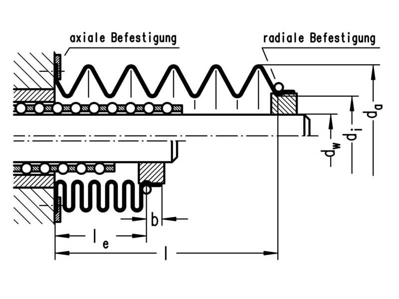

Chrome Leather Bellow
Art. no.
- The relationship between the inside diameter di and the outside diameter da has been selected to give the bellows good stability.
- Optimum contraction ratio (l/le).
- Unlike rubber or plastic bellows, leather bellows do not impair the smooth running of the rotary stroke bearing.
- The natural material is resistant to most environmental influences. (Caution should be exercised when using certain coolants!)
N 820/di/da/l/le
- .../a for axial clamping
- .../r for radial clamping
- .../a, r for axial and radial clamping
MarMotion | Item no.: | |
Fastening method | axial clamping |
Formula for bellows infeed length |
le = l · q q = factor for contracted length le |
Shaft diameter (dw) | 14-16 mm |
Outer diameter (da) | 45 mm |
Inner diameter (di) | 27 mm |
Extraction length, max. | 500 mm |
Factor for infeed length (q) | 0.25 |
Sleeve length (b) | 6 mm |
